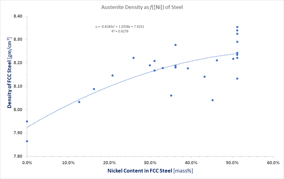

    I made a plot (below) of data taken from x-ray diffraction PDF cards from the 04-XXX-XXXX subfile, about 28 cards total of Fe-Ni alloys of point group 225 at STP, and the scatter is huge regardless of a linear or nonlinear best-fit curve.  I suspect some of the cards were not measured at STP, confused mass% with mole%, or contained other unspecified elements in more than trace amounts.  I am hoping to find something a little more definitive than this, but I have had no luck finding any such paper.

    Richard is this plot for a single composition of steel, or a collection of values for different steels of different chemistries?   if you collect data for several different austenitic steels of different Ni content, I don't think you would expect to get a smooth a curve because the density also depends on other elements not being considered on the x-axis. This is something that may be possible to calculate using a CALPHAD database for steels which could be used to calculate the density variation as a function of chemistry taking into consideration variation in the other alloying elements.
