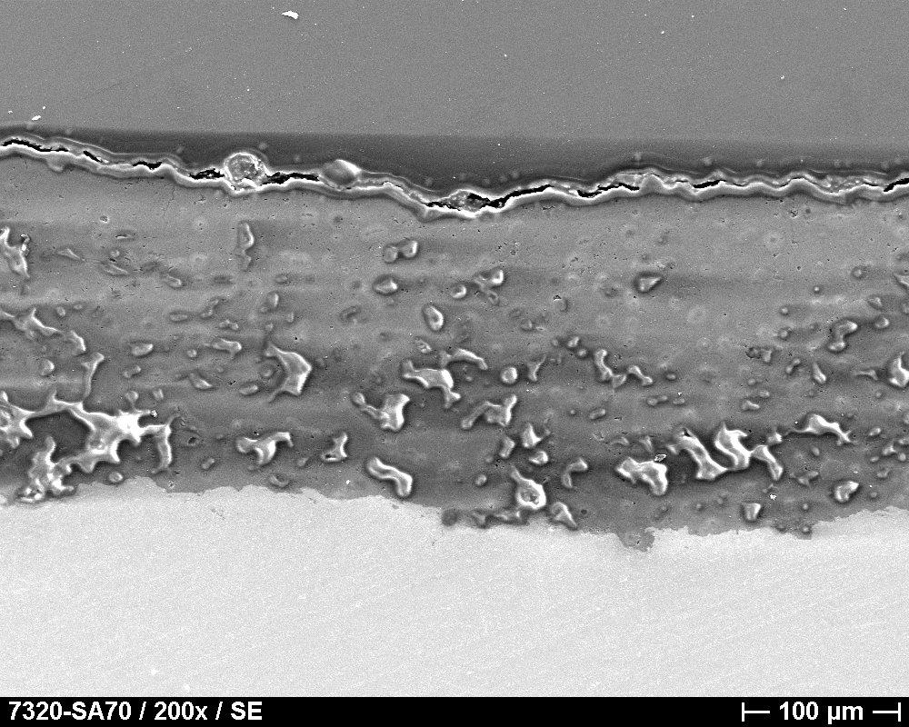

    Dear Thermal Spray Community,
    currently I`m facing a problem regarding the optical characterization of Al2O3 coatings. During SEM analysis, a liquid is visible on the specimen surface. It comes out of the pores. Probably the liquid is pulled out of the pores by the vacuum in the SEM. I have already tried to fix the problem by placing the samples in the vacuum oven at 80°C for 3 hours. With no success.
    The sample was only in contact with ethanol and a water-based suspension while grinding and polishing the sample.
    Has anyone had a similar problem in the past and was able to find a solution to it?
    Thank you in advance!

    - from the photo you seem to have a serious problem with resin adhesion to the sample. You should use resin with minimal/zero shrinkage, especially if you have a smooth coating surface. BTW, I have seen samples where wrongly chosen epoxy delaminated the whole coating (even after several weeks! - bad for samples archivation) although the coating was otherwise OK.

    I got some great news regarding the liquid leakage from pores. Rogerios metallographic trick with the woven fiber which absorbs the liquid worked wonders. It saved a lot of work, otherwise we would have needed to prepare completely new samples.
    Thanks to all these valuable recommendations! I talked to our technician and we managed to improve our metallography process (e.g. vacuum to the sample prior to pouring resin, more vacuum cycles, dish detergent trick)
