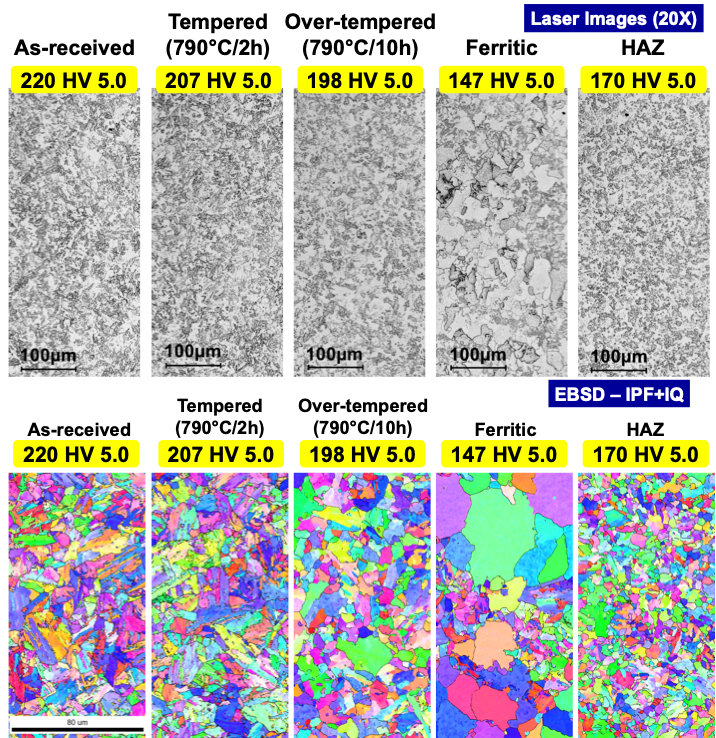

    Thomas, there are a lot of different resources available to you and historically optical metallography was a primary tool.  At EPRI, we have unfortunately seen a lot of bad optical metallography from laboratories working on CrMo steels and bad interpretation.  I think for some phases a combination of hardness and optical metallography can give you useful information, but depending on what you are trying to do, today's SEM's and in particular the use of EBSD can be highly valuable for such an analysis of steel samples where the subtle differences will not be apparent optically.  Unfortunately I don't have an atlas of microstructures to point you to with these newer techniques, but to give you an example for a steel we work with frequently, the images (sorry post makes them poorer quality than they really are) shows that optically (in this case using our laser scope) you don't see a large difference in 4 out of the 5 different material conditions for the same heat of material heat-treated in different ways, but EBSD allows you to clearly see differences.  While hardness differences are moderately different for some of the cases, the high-temperature performance (creep) in this alloy system can vary by a factor of 100 based on this starting structure.  This may be more than you need, but this is what we are working to.  I would be interested to know what kind of atlas of microstructures would be useful to you; I personally believe ASM could build such tools to help us all building on much of the historical data but also using these newer methods beyond Optical metallography.

    John's email on EBSD is certainly useful (and a great example), as some of these things are definitely difficult to interpret with optical microscopy - and it is not always done well.  However, those are often still the tools available to us right now, and a great deal faster than EBSD.  Sadly, I have neither a confocal microscope or an SEM myself!
    George Vander Voort and I are presenting a webinar covering preparation, etching and identification of microstructures in Carbon and Alloy steels with light optical microscopy.  This is part of a series of webinars on the last Wednesday of each month - all on etching and microstructure identification for different material groups.  We will have Q&A and follow up any questions raised in the webinar. I'm running these webinars because there are always a lot of questions about selection of etchants and microstructure identification!  Buehler Upcoming Webinar Sign up

    Great Michael, I will pass this onto some of our metallographers and I appreciate the references.  One challenge we've been having is our safety team always seems to be changing their opinion on 'safe' etchants.  Many of the older etchants are no longer available for us to use; the confocal microscopes have been a great addition in this case; with proper sample preparation (sometime a 20hr vibratory polish) we can actually see the grain boundaries and some structure without even needing to etch.
