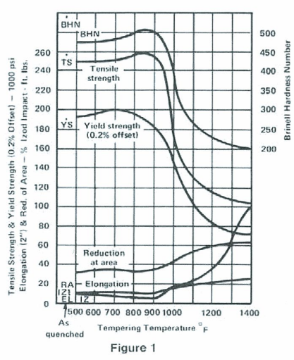

    Something similar to this...
    David Coulston
