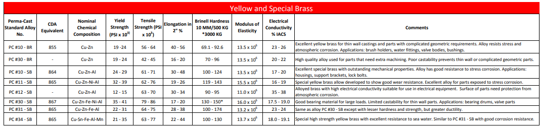

    A customer has specified two copper alloys on a part drawing sent to us. The first one is 'PC-12 SB Brass' It has a tensile strength of 63 - 70 Ksi and elongation of 30-34 % in a 50 mm specimen. The electrical conductivity is 35 - 38% IACS. The second one is CDA 815 with tensile strength of 54-59 Ksi, elongation of 20-25 % on a 50 mm specimen and IACS - 70%. The only additional information I have is PILAD. I guess, this is the name of the original manufacturer which does not exist anymore.
    I am unable to find a UNS number or any other standard equivalent. I will greatly appreciate if anyone can help me with finding the UNS equivalent grade or tell me that this is a variant of a std grade.

    Posted 08-07-2024 08:08
  • 10.  RE: Copper alloy - Brass Specs
    Posted 08-07-2024 08:49
    If the table attached by David is correct the alloy PC-12 could be UNS C86100; but the strength will be higher and conductivity will be lower for C86100 than prescribed above. If you need 30-35% IACS then the Zn and Al content need to be lower.

    The table sent by David is correct. That is the table we found. I will look up C86100, but feel CDA 864 which is a Cu-Zn-Al alloy is closer in specs to PC-12. If the Zn -Al content is lowered experimentally, the conductivity will probably increase due to higher copper % and the right heat treatment. Thanks for your help Mr Sadayappan

    Yes thats the one. We have this table - probably from the non-existent manufacturer's website. You will notice that PC#12-SB does not have an equivalent grade mentioned against it, nor do we have the composition. This is the data we are trying to find out.

    Thanks Aaron. PC-12 is a manufacturer spec. Unfortunately, the manufacturer doesn't exist anymore and hence the search for an equivalent.

    Are you sure about that? PC-12 looks like a proprietary alloy that is produced by Perma-Cast but they still seem to be in business and their catalog that includes available product forms is online. They are located in Pueblo Colorado.

    The properties you provided really indicate the specified material is proprietary Perma-Cast PC-12. I wonder if your supplier was really supplying this alloy, or whether they just were supplying some imitation. I again suggest you contacting Perma-Cast directly regarding getting the specified material. Your alternative is to perform an engineering review to find an acceptable material meeting the operating and structural needs of your actual application.

    The alloy specs I am looking for is not made by PermaCast. Permacast is a part manufacturer and uses PC as a suffix for some of their catalogue items. It has no connection to any alloy spec.

    The alloy we are looking for is NOT from PERMACAST. It is just a coincident that the alloy spec has a PC in its name. The Permacast Website that colleagues on the group have visited, gives no indication that they ever manufactured any alloy. Some of the parts they make are numbered/identified with a suffix PC.
    The Company that did make this alloy was known as PIAD, which does not exist anymore. The alloy is not patented, if it was, we would have found a patent. Assuming it did exist, I am sure it expired many years ago. So we are now re-inventing the wheel. Thank you for mentioning Woldman's Engineering Alloys. I will try to find and see if this helps.

      |   view attached
    FYI, I found the attached on-line. I believe it qualifies as a published document. Perma-Cast location and phone included

    As I mentioned in an earlier post, we found this table and cannot find PermaCast - the alloy manufacturer. I will try once again with the phone number you have provided. Thank you for your effort and help.

    Here are a couple of links to where you can access the Perma-Cast table that lists PC #12-SB Brass
    Perma-Cast Selection Guide I Export, PA
    Alloy Selection Guide.xlsx (hibu.com)
