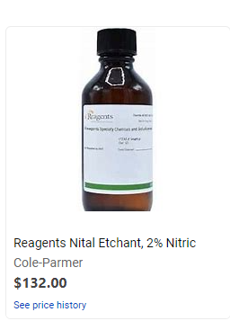

    Adding more info to Ratnesh's suggestion. I saw Cole - Palmer is selling 2% Nital reagent. I also listed Avantor (VWR) and Qatm (Verder Scientific).
    Verder Scientific do customize reagents as customer needs. Our plant in Canada also has the same issue so I know for sure it is out there.
